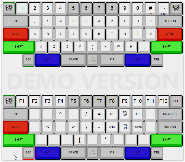

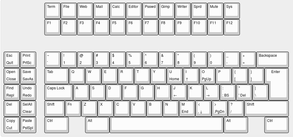

Hello,
A few weeks ago I made up my own keyboard layout out of interest, and ended up with this:
http://www.keyboard-layout-editor.com/# ... 3ee3cb9814
The keys with * are used by holding the FN key.
The menu key is the one next to alt gr (never used alt gr in my life).
The super key is the windows key basically.
Anyways anyone up for a layout discussion? How many keys do you need/are willing to use?

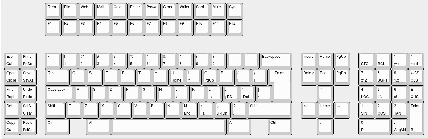

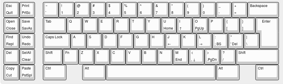

Hey, thanks for the link! I never knew that site existed. Here's one of my current layouts:
Some of the lower legends refer to function-layer assignments.
I don't know what the optimum number of keys is; my smallest board has 62 and the largest 122. What I find really useful is the cluster of 10 keys on the left side. They come in handy for editing in conjunction with the mouse. So I guess the smallest keyboard I would be comfortable with for everyday use would be something like this:
Since my keyboard sits in a drawer, there is really no reason not to add back the function keys to produce what I would consider the ideal keyboard layout:
Make one of those with capacitive buckling spring switches, and I'll buy it immediately.
I haven't made the transition to ergo keyboards because I would miss all my old IBM boards terribly. I haven't really given Colemak/Dvorak/etc. a try yet either because I'm not sure they would help coding that much. What I need is a layout where parentheses, brackets, braces, etc. aren't such a reach. I don't know if anyone has undertaken a study of layouts optimized for programmers. It would depend somewhat on the specific language I suppose. For LISP, put the parentheses on the home row and you're good.

"What I need is a layout where parentheses, brackets, braces, etc. aren't such a reach."
Yeah I have a degree in Java programming but I never program lol, so I haven't made it programmer friendly.
I would really have to pick up programming again to make my layout more optimised.
The KB is small however, so maybe someone with bigger hands can reach it?
I really made this KB to try out a straight forward layout of the keys, to have them next to each other equally. I don't know if it will help at all with anything, or be a hindrance.
I've started PC gaming and just have problems past the WASD QER F keys.
I figured this will help, because I also moved to a new layout (Colemak) and use ESDF keys too. The alt key is that way for gaming too.

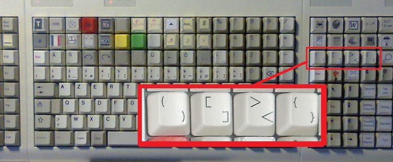

Proudly presenting my solution:quantalume wrote:[…] What I need is a layout where parentheses, brackets, braces, etc. aren't such a reach. I don't know if anyone has undertaken a study of layouts optimized for programmers. […]
On each of these keys a single stroke prints both the opening and the closing sign and places the cursor between them.
Without being a programmer, I find this a real help

Too many keys for me, I tried to reduce the number of keys necessary for my KB.
At the bottom of some keys you see *insert etc, these are keys activated by holding the FN key.
When programming [] were used for arrays and { } for block statements right?
The {} keys as is require shift to be held down already, but that's done on the left hand (atleast for me).
I might move them over.
Also F11/12 are on the right hand side because I use them more than the ones on the left.
I'll try and revise the layout with this feedback.

"Layer1 keys are shifted." So if you tried to Shift+a to make A, you would get ! instead?
If so, how do you get capital letters? Caps lock?

No, I mean that if I keep pressed ~L1 (located on the bottom row right hand on the right of the thumb cluster - basically exactly under the right hand thumb) and press "A" (without holding shift) I get "!".RadikulRAM wrote:

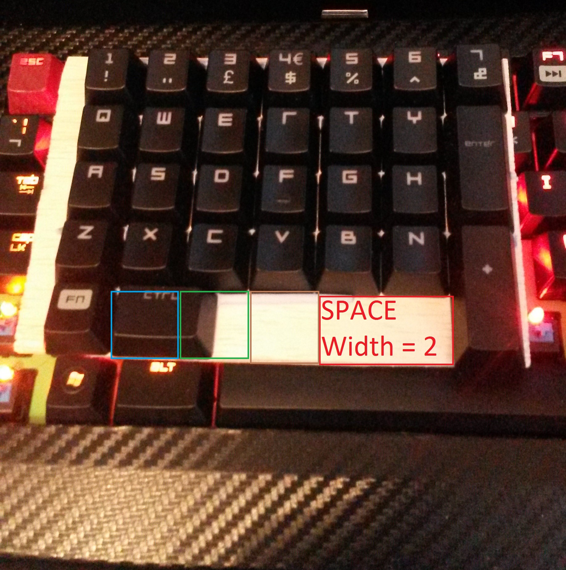

Here's a picture of what I've gone for, I pretended to type on it and a 2 wide spacebar feels fine.
The other difference is that the enter key, is actually two normal size keys, and the + is backspace.
All of the keys are size 1, space and backspace are size two.
The biggest reason why I wanted a symetrical layout, where the keys are layered under eachother as they are, is so I can hit the correct keys when playing games better. This placement seems to have helped. Also I'm tired of moving the entire keyboard to the left, and moving it to the middle when not gaming. (That's why I want two pieces).

Capewell symmetrical: http://www.keyboard-layout-editor.com/# ... 726291782c
Should I go with the bottom or top layout? I like the symmetry of the top, but the bottom is more functional due to the dual esc keys (VIM) and backspace. The bottom also shows the Fun layer.

I think you should go with functionality more than anything.DerpyDash_xAD wrote: Capewell symmetrical: http://www.keyboard-layout-editor.com/# ... 726291782c
That said, I don't use Vim, but if the esc key is commonly used how about moving it to a more easy to reach location?
Like the FN key, or alt.

I need an escape key imho. I could trade the caps and esc, as shown in the image.
It's looking like my best bet may be either a red enter or uncolored mods.
