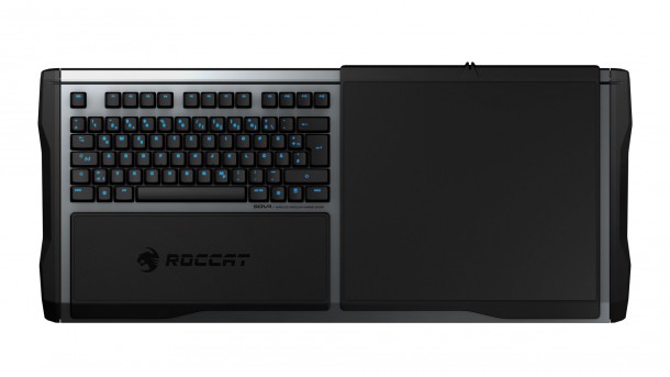

Hey guys, a few days ago i watched a video presentation of the Roccat Sova in E3. As you may have guessed it made a big impression on me and i started digging up. It turned out that it will be launched in 2015 so since i do not have any ongoing projects (keyboard and non-keyboard related) i thought of giving it a try. My first thoughts were to make the case out of wood(my prefered material) and leave a hole where the keyboard should be so that i can then utilize a plate mount(no pcb, it will be hand-wired). From previous experience, wood makes a rather good surface for mouse, provided it is well sanded and finished. Also, i think it would be good looking. I've made a few sketches but i'm no artist, so i wouldnt feel comfortable uploading them. :oops:
Now, before i get down to the tricky parts, i would like your help to resolve the standard.
The Layout: i believe that the dimensions of the Sova's original layout are a must in order for the whole device to remain in a manageable size(i forgot to mention that i will not be using any of the sliding extentions roccat has installed in the sova). The problem is that even though i am ok with giving up the numpad and the Insert, Home, End, Page Up, Page Down, I would like to retain the arrow keys and the Delete button.
The Plate: By reading the previous topics in the workshop, i concluded that an aluminium plate would be better for this one due to less weight than steel. But, i really suck at designing stuff on pc, which means that i will need your help on that. As for cutting it, i believe i can find a shop with a laser cutter or something able to cut the plate accurately in my city.
Now, to the complicated stuff.
Connectivity: I have absolutely no idea how to make it wireless and if it will have an acceptable response time. Will it utilize a Teensy which will ultimately connect to a Bluetooth transmitter, or is there something like an all-in-one for that? I should mention that it doesn't necessarily have to have usb ports for other devices and all that funky stuff of the Sova. Though it would be awesome to operate both wirelessly an by usb.
Extra Battery: Since there will be a ton of unused space in the case, i thought of adding something to make the wireless operation last longer.
Lastly, i would like to add leds because when the lights are off(very common for me and very frustrating with my current non-backlit keyboard) the keys should be visible.
Guess that is pretty much it. Big thanks to anyone who can help out.
p.s. I realise i base this keyboard on the Sova without even showing a picture so here is one:

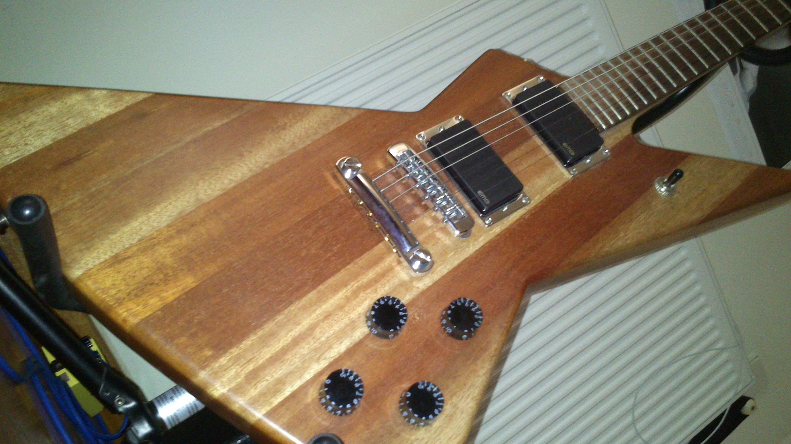

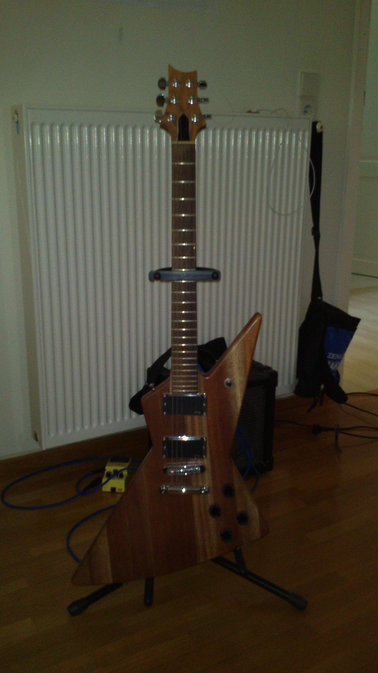

Pics of the guitar, please. :)
JohnGR
02 Jul 2014, 14:42
Thanks, actually the lap desk seems pretty good but my current keyboard sucks and i dont use tablets so i would have to get one of those and then make a keyboard whick would be more comfy but a lot more $$.
Now for the guitar. It is something of an Explorer though i drew the outline by hand, it is mahogany with rosewood fretboard and a piece of olive wood on the headstock. Active EMG's and les paul-like controls(knobs and switch). So, It is a mixup of the things i considered best in the guitar world(at the time). The photo quality isn't the best but i hope you can make out something...
explorer 2.jpg (941.72 KiB) Viewed 7840 times
explorer 1.jpg (747.44 KiB) Viewed 7840 times

I agree would love to see pictures of the guitar. That's a project I once attempted a couple years ago, and quit when I ran out of funds, and subsequently lost motivation... :lol:
I personally am not a fan of this Roccat Sova thing at all, I find it is just way too freaking big, and I would rather something like Lowpoly posted and actually just stick my keyboard and mouse on top of that, so I could work in that setup when I wanted (but still have the option to move my keyboard around).

Something else I wanted to mention, I would really work on the layout of that Roccat desk thing. I am not sure how much I like how the keyboard is all the way to the left, with that massive trackpad (that is what that is right?) on the right. If you rest that on your legs or what ever, that seems pretty unbalanced. Also something like Apple's Magic Trackpad, might be a much more manageable size for this type of project. That or if you really did like the size, or wanted something more controllable, you could try to implement something like a Wacom drawing tablet. The ones they make now a days also include touch and gesture control, so you don't have to use the pen if you don't wish.

EDIT: Beautiful guitar by the way. What types of hardware are you using? Pickups?

EDIT5: I also now realize that the section on the right is actually a mouse pad I think, not a massive freaking trackpad. In that case, one major tip I can give, is MAKE SURE that the mousepad you use is not only highquality, but it is REPLACEABLE! You also don't want to track your mouse around on the bare wood. It might work fine, but trust me, in the end after a lot of use it will wind up dented, scuffed, and no where near as pretty. Especially if you "game". Also have you considered using trackballs? While they aren't for everyone of course, a Trackball would be a hell of a lot easier to install here, and (in my humble opinion) are a million times greater then a mouse :P

The thing in the right side of the Sova is not a trackpad though. It is a mousepad that can slide, if need be, to the right for more space, which i personally think is not needed. As for the balance, i can't say for sure but i believe that it pretty good because the whole device has a battery pack in the right side which will probably counter the weight of the keyboard on the left.
Thank you. The bridge, the tailpiece and the tuners are from Schaller(i don't really remember the code names...) the pickups are EMG actives, the 81 and 85 i think, and the nut is artificial bone by Tusq.

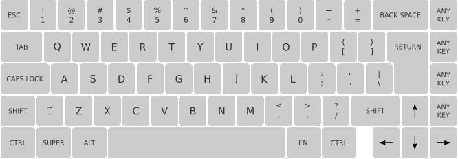

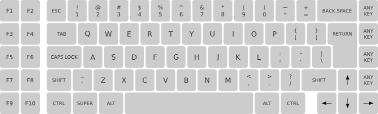

So, at pyrelink's suggestion i searched the whole topic of the group build. The only layout i found which is what i dreamt of is this, without the F rows:
layout 1.png (29.44 KiB) Viewed 7752 times
Now, will i have to make my own file for the plate cutout(and if so which program do you propose to use?), or is there someone who has it already? I do suck in designing stuff on pc so you're doing me a big favor...
Also, at pyrelink's request i will start uploading my sketches of the whole thing. :)

Split the space bar and go for an fn layer.
JohnGR
03 Jul 2014, 00:34
DerpyDash_xAD wrote: Split the space bar and go for an fn layer.
Thought of that at first but then realised that i have never used the right Alt so probably the Fn button will replace it.

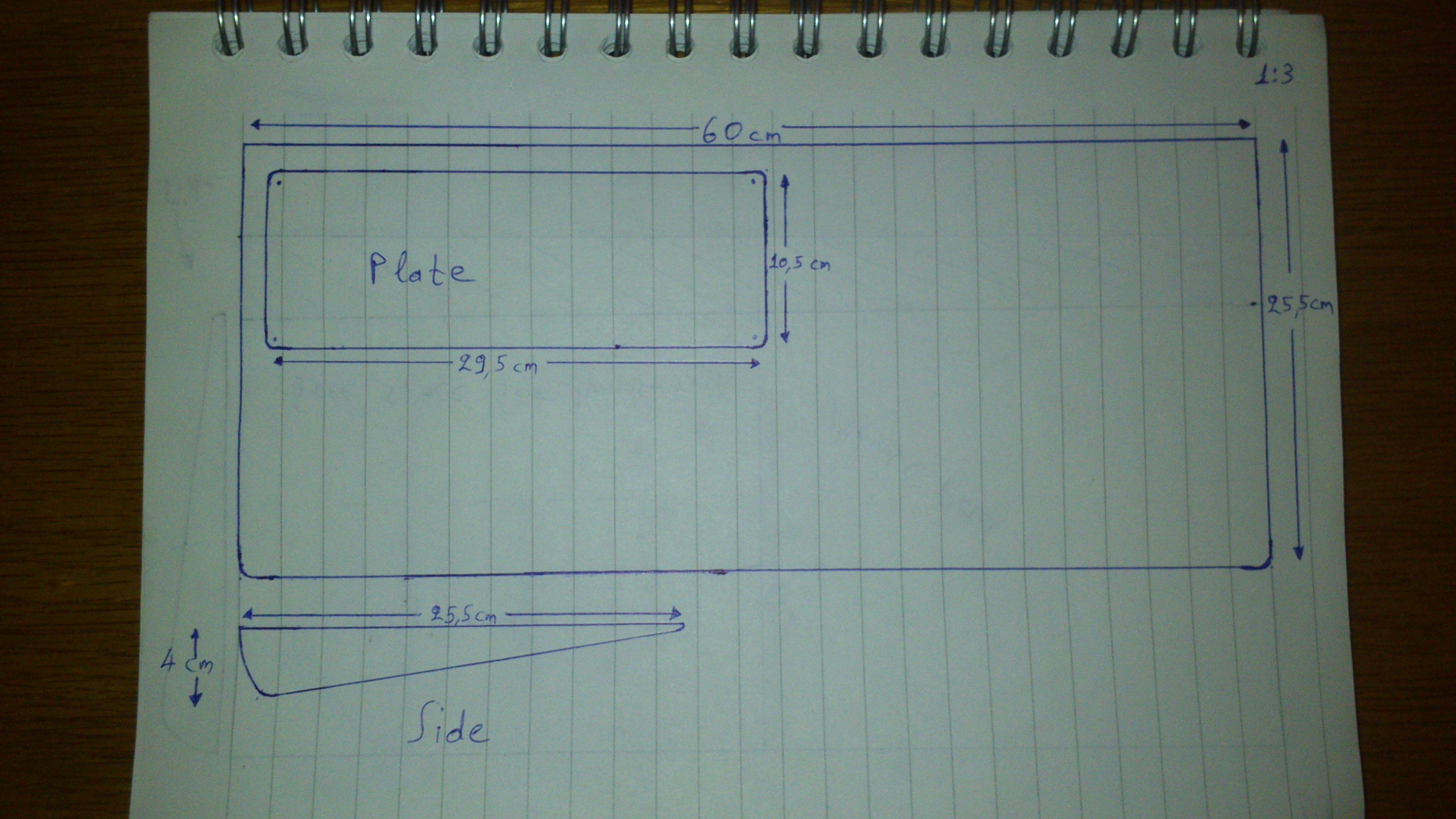

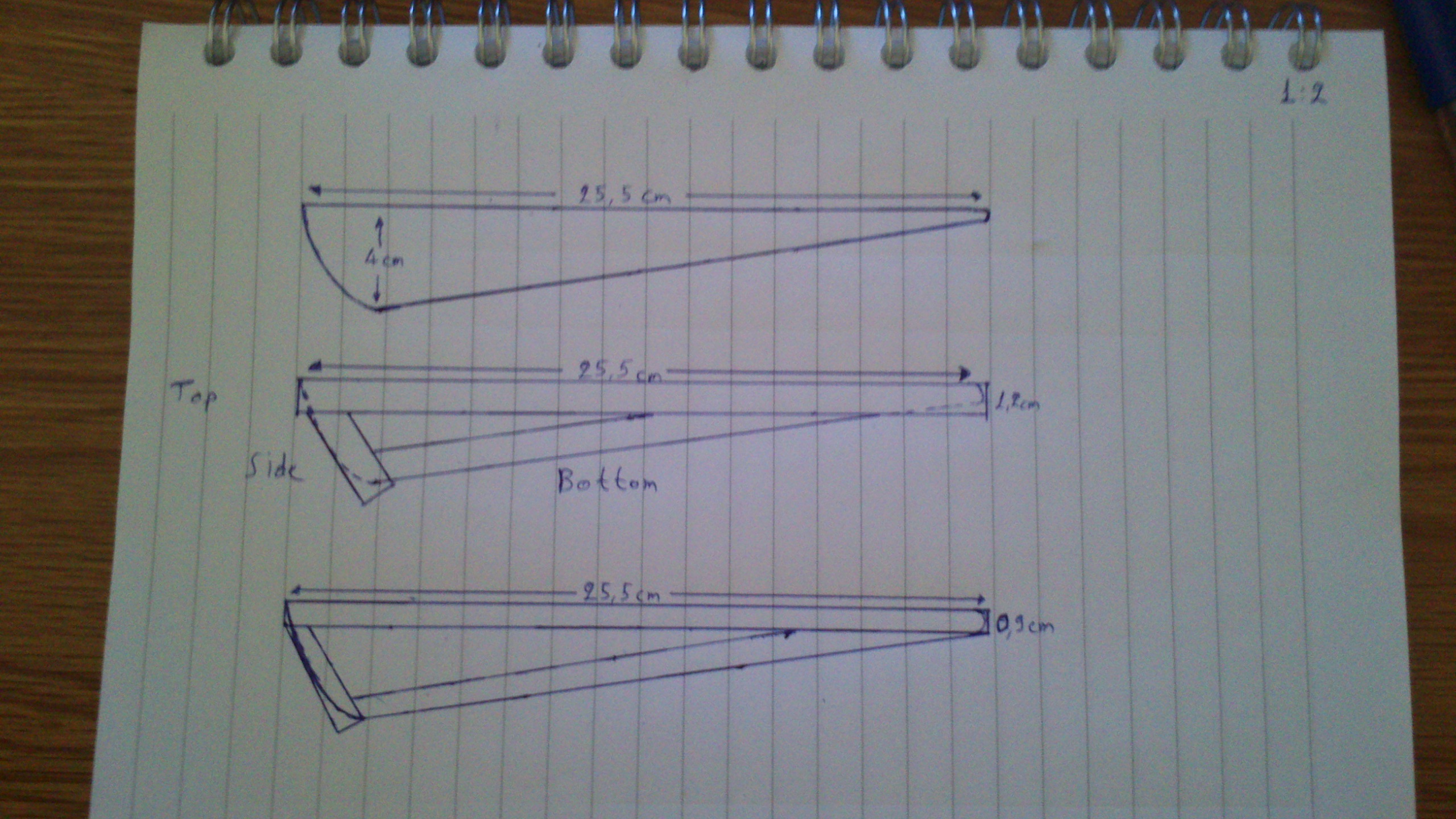

Building the case might not be that hard after all. I am most likely going to use birch plywood. In the sketch below i tried to show how the pieces would connect as well as be shaped to the final stage. At first i tried with 12mm thick but it seems too bulky with very limited space inside and probably too heavy. So, next was 9mm which seems much better. I don't think it could go much thiner because it would be really unstable and hard to mount the plate successfully.
drawing #3.jpg (818.6 KiB) Viewed 7650 times
lowpoly
03 Jul 2014, 12:36
Is that the left or the right side?
JohnGR
03 Jul 2014, 12:44
lowpoly wrote: Is that the left or the right side?
The left, the keyboard will be on the tallest side, because i will mostly be using it on my desk and i really like the keyboard to be inclined. I don't think it would make much difference for using it on my lap, but if it is uncomfy afterwards, i will add some removable pillows or something. That way, it will be usable on the desk and the couch or bed. :-)
At first i thought it was clear which side it was, that's why i didn't mention it, but after your comment i realised it could be both ways...
lowpoly
03 Jul 2014, 13:09
I thought it was the left side, but for lap use the incline should probably the other way round. Or pillows, like you said.

03 Jul 2014, 14:56

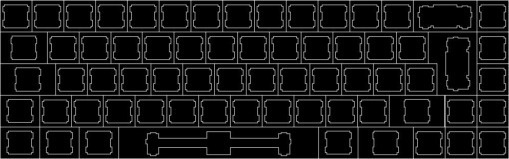

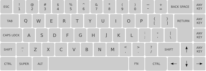

Today i tried my luck with computer designing and i made a plate cutout blueprint as well as a modification to the layout to show how it will look in the end. So, here goes:
layout 2.JPG (21 KiB) Viewed 7610 times
Now, the cutout is not really ready because i noticed while scrolling through the files i used of each key that they have slight differences, which means that the switches will probably not fit. Also, i don't know how ISO Return keycaps are positioned, so i just used a Backspace slot sideways for the Return.
plate cutout.JPG (66.52 KiB) Viewed 7610 times
Can anyone help and send me the accurate dimensions for the holes? :|
03 Jul 2014, 17:06
JohnGR wrote: So, at pyrelink's suggestion i searched the whole topic of the group build. The only layout i found which is what i dreamt of is this, without the F rows:
If you are not having any function keys, maybe you could use the Red Scarf II PCB which will be available in an upcoming GB. It will have three unused columns of keys to the right, but you will have a mouse pad there. I can see a problem if the plywood is too thick though. I thought you were going to use a metal top and bottom like the Sova.
Red Scarf has a modified version of Hasu's TMK firmware with support for backlighting.
JohnGR wrote: Now, will i have to make my own file for the plate cutout(and if so which program do you propose to use?), or is there someone who has it already? I do suck in designing stuff on pc so you're doing me a big favor...
I use QCad and cut and paste from existing plate designs that are available. I use one drawing layer for the plate cutout and another layer for the key outline but you will quickly learn how to use different reference points when copying and pasting.
QCad outputs DXF which is a common CAD format that can then be imported into most CAD and vector drawing programs such as Inkscape.
You could reuse the Phantom plate design for ISO and modify it.
BTW. The switch for the ISO Return key is in the centre of the 1.25u×2u rectangle that fits within its area. All stabilised keys except the Space bar has the same width of stabilisers as 2u keys such as Backspace. If you are using Cherry stabilisers and a PCB then you must be certain that there is no component on the top of the PCB where the stabilising wire goes.
If you are using Costar stabilisers, then the wire must be on the same side as the switch's diode opening.

05 Jul 2014, 15:05
So, I updated the layout and replaced the right Ctrl key which was 1x1.75 with a normal 1x1.25 beacause i don't think i'll be able to find a 1x1.75 Ctrl keycap.(if i end up using printed and not blank keycaps)
layout 2.JPG (21.04 KiB) Viewed 7542 times
Next, i made a decent plate cutout drawing using QCAD and an extremely detailed and useful compilation of phantom plates designs in dxf that Findecanor uploaded on a previous topic. I cant upload it directly so pm me or reply here if you want it.
Still waiting for someone to suggest about switches and keycaps(i'm a total noob here, and i haven't ordered/bought any before so i lost it in the marketplace sub-forum)... Thanks in advance :)
