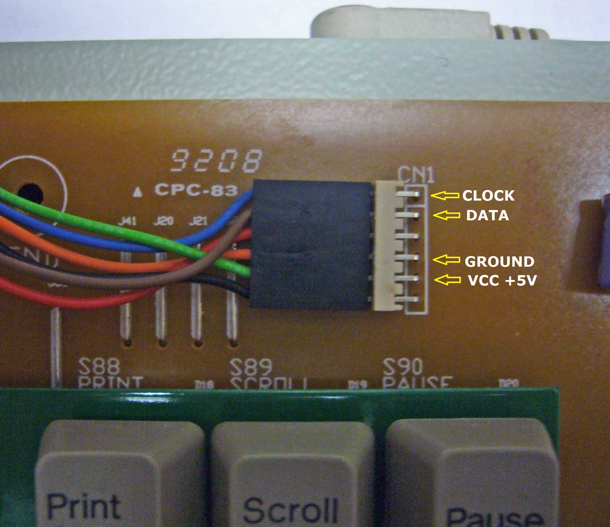

04 Sep 2014, 20:13
I don't think the northgate boards ever supported ADB , a normal male to male ps2 cable should work mine did as i lost the original cable
http://www.amazon.co.uk/Male-Keyboard-M ... B003531FDU
northgate supported AT,XT and amega if my memory is correct
does your northgate have dip switches ?
http://www.lueckdatasystems.com/attach/ ... y_2_08.jpg
05 Sep 2014, 01:23
I suspect that somebody supplied the wrong cable with this keyboard.
A male-male PS/2 will not work. The original cable looked like a PS/2 (aka mini-DIN6) on one end and large AT-style connector at the other.
I used a common PS/2 cable on my Omnikey 101 when I hooked it up like this:
05 Sep 2014, 10:01
the socket on the back is a standard PS2 with the standard pin out, this can ether go to an AT plug or a PS/2 plug , both are electrically the same just a different connector. Trust me when i lost my cable i had to make one up :)
small caveat however mine was an ultra T not a 101
05 Sep 2014, 14:31
I have never taken anything apart except for the 101s. Fortunately, I had 2 of them and an original cable that I was able to trace with a multimeter.
