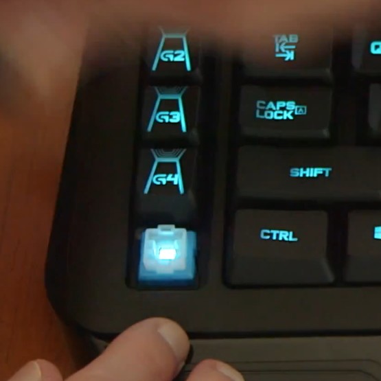

From http://www.youtube.com/watch?v=k5LMS7ycx0g
Keycap pulled of a "Romer-G" switch.
Romer-G youtube.jpg (32.18 KiB) Viewed 14741 times

Looks interesting, I like that the LED is in the middle, distributing the light evenly should be easier this way. Maybe it's not as bad as i initially thought.
Kurk
17 Sep 2014, 17:26
The light will be bright in the center of the keycap and fade off quickly. That's clearly visible in the frame grab of the youtube video. Look at the larger keycaps like shift or Ctrl. The major difference with illuminated, current MX switches is that the center of the cap is brightly lit as opposed to the bottom (or top). Well, maybe it's a bit more evenly distributed. We'll have to see in real life. What the heck, I don't even care about illuminated keyboards...
