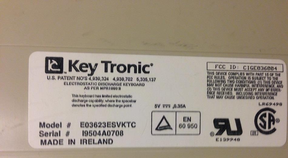

So having lurked on these forums for quite some time now i finally decided to to register (hello everybody :D )
Putting that aside for a moment though, when i was recently checking a local online store for any deals, i stumbled upon a (way overpriced) key tronic keyboard whose label caught my attention.
At first, i just thought they where talking about the switches themselves, but after goggling a little i found out that this 'electrostatic discharge capability' was apparently a technology patented by Key tronic in 1992.
http://www.google.com/patents/US5335137
So has anyone heard about this before? I sure haven't and does that mean i can discharge myself by just touching the space bar? I didn't really get it.
Oh, and please excuse my bad English.

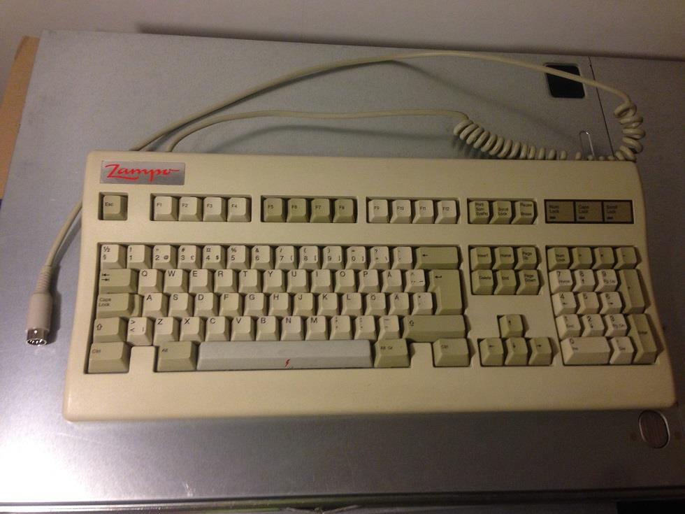

Jimi14
20 Oct 2014, 22:47
Didn't think it looked that special, but after taking a closer look it seems to have a lightning legend on the space bar.
If its true, then it might at least explain its unusually high price for an 10 year old, non-mechanical, keyboard.
Still don't think i'am buying it though
21 Oct 2014, 00:12
The space bar is connected to shield. That's it ... It shouldn't cost more than 10 Euros.
An old Key Tronic I have has a mushy feel. But my ErgoForce and my OEM keyboard (smaller and flatter) are not, and the ErgoForce has that kind of space bar. The good Key Tronic rubber dome/membrane keyboards last long and keep their feel.

The UK-made Model Ms used to have a spacebar grounding wire.
chzel
21 Oct 2014, 15:43
Yes, but the spacebar itself is not conductive.
So the wire prevents the key from accumulating a charge, but does not discharge your body.
As, for the KeyTronic, being ESD-safe means it targets a very specific niche market, and that drives the price up.
For example a simple antistatic mat ~A3 in size easily costs 50€.
21 Oct 2014, 21:32
Nah.. Every Key Tronic ErgoForce I've seen have had the antistatic Space Bar.
