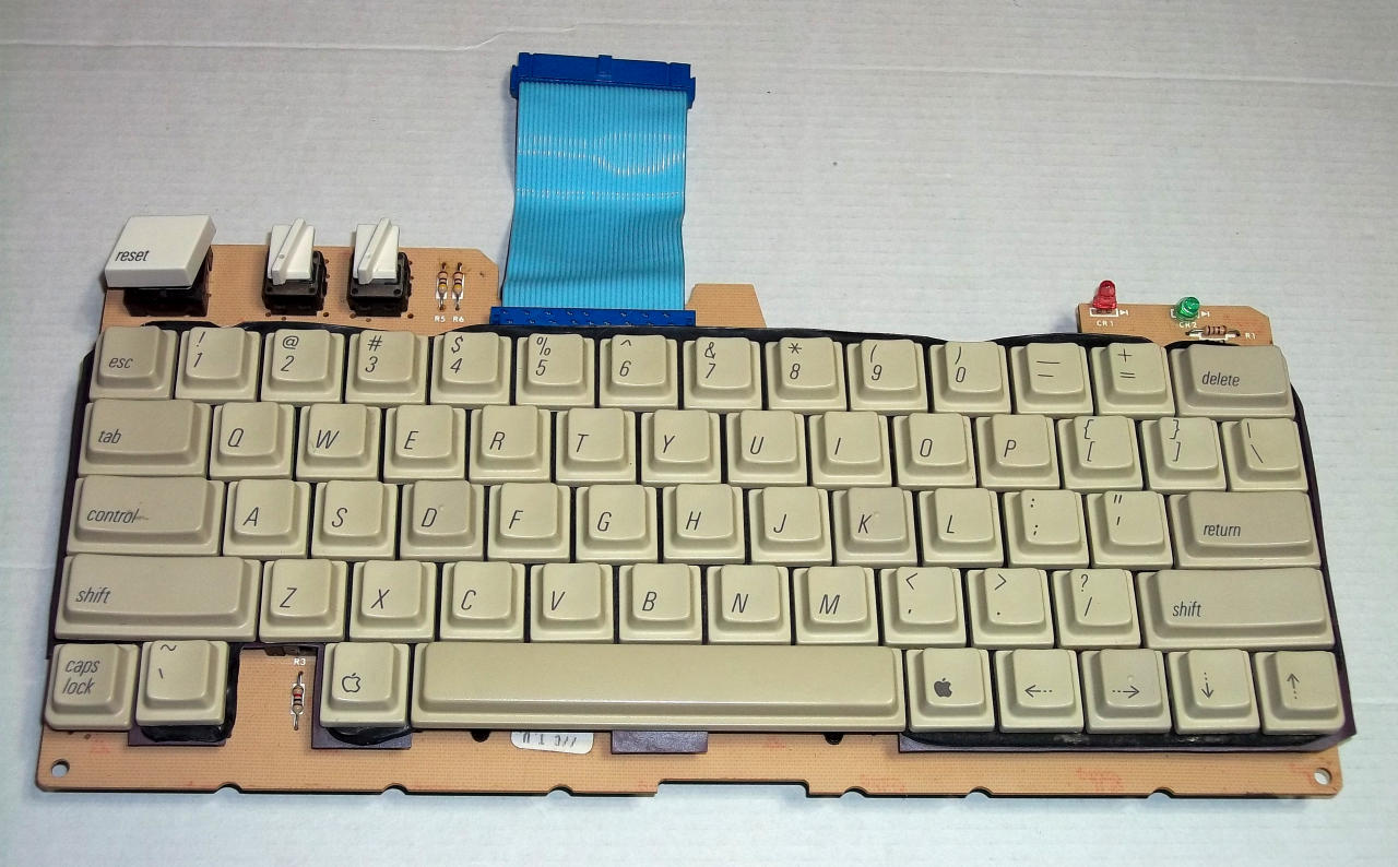

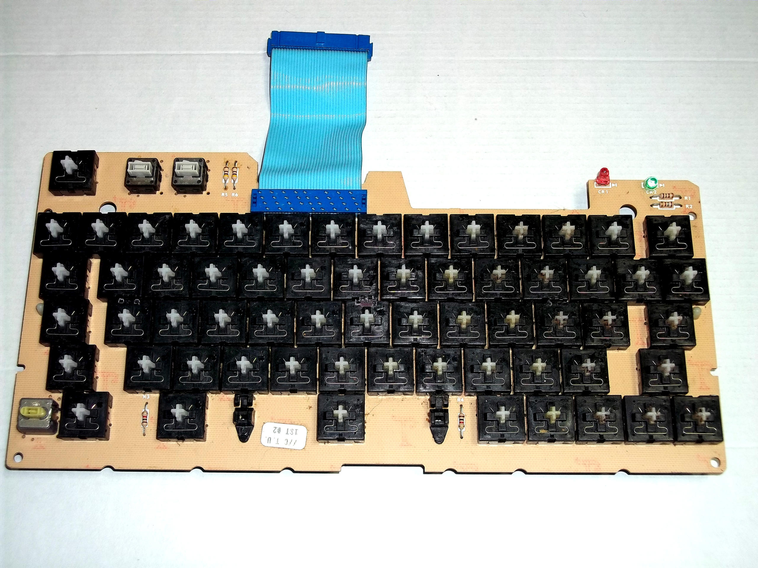

Following a PDF that jacobolus used as a reference on the wiki, I asked its author, Ken Buchholz (the same chap who I bought my amber Alps switches from), if I could have and use the images from it.

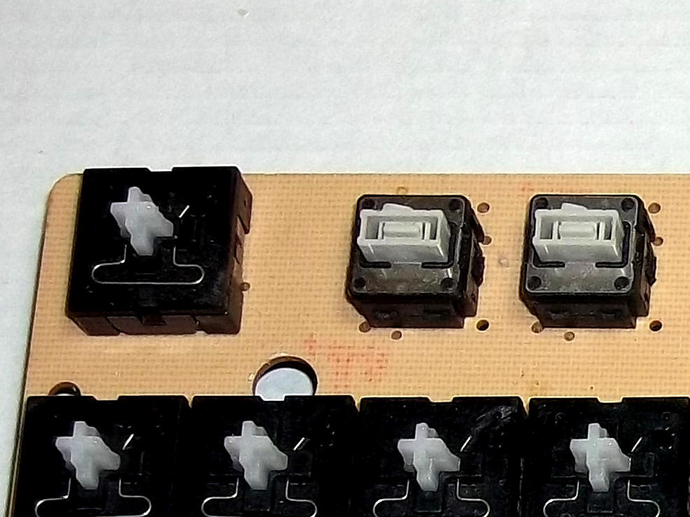

He took some fresh photos of what should be the same keyboard, but isn't. What's puzzling is these switches at the top:
Atlanta Photocircuits Keyboard -1.jpg (122.92 KiB) Viewed 1730 times
The IIc uses three latching switches. On this keyboard, the 80/40 and Keyboard switches are of the unknown type, while caps lock is [wiki]Alps SKFL Lock[/wiki] as expected!
Atlanta Photocircuits Keyboard 0.jpg (173.66 KiB) Viewed 1730 times
Atlanta Photocircuits Keyboard 3.jpg (693.3 KiB) Viewed 1730 times
The keyboard is also missing its Atlanta Photocircuits branding, so it's not clear who actually made it; it's only branded Apple.

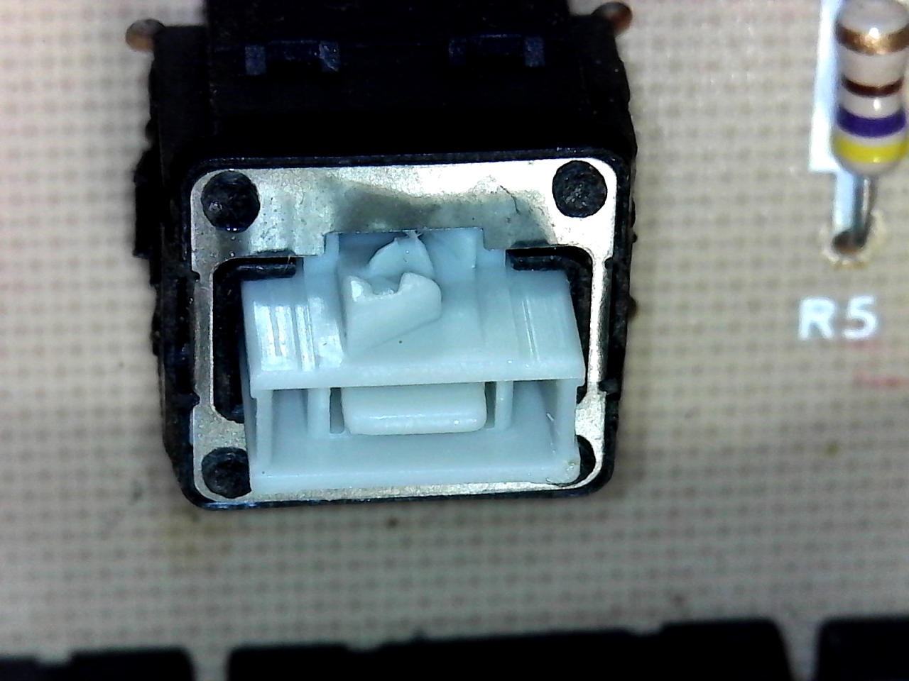

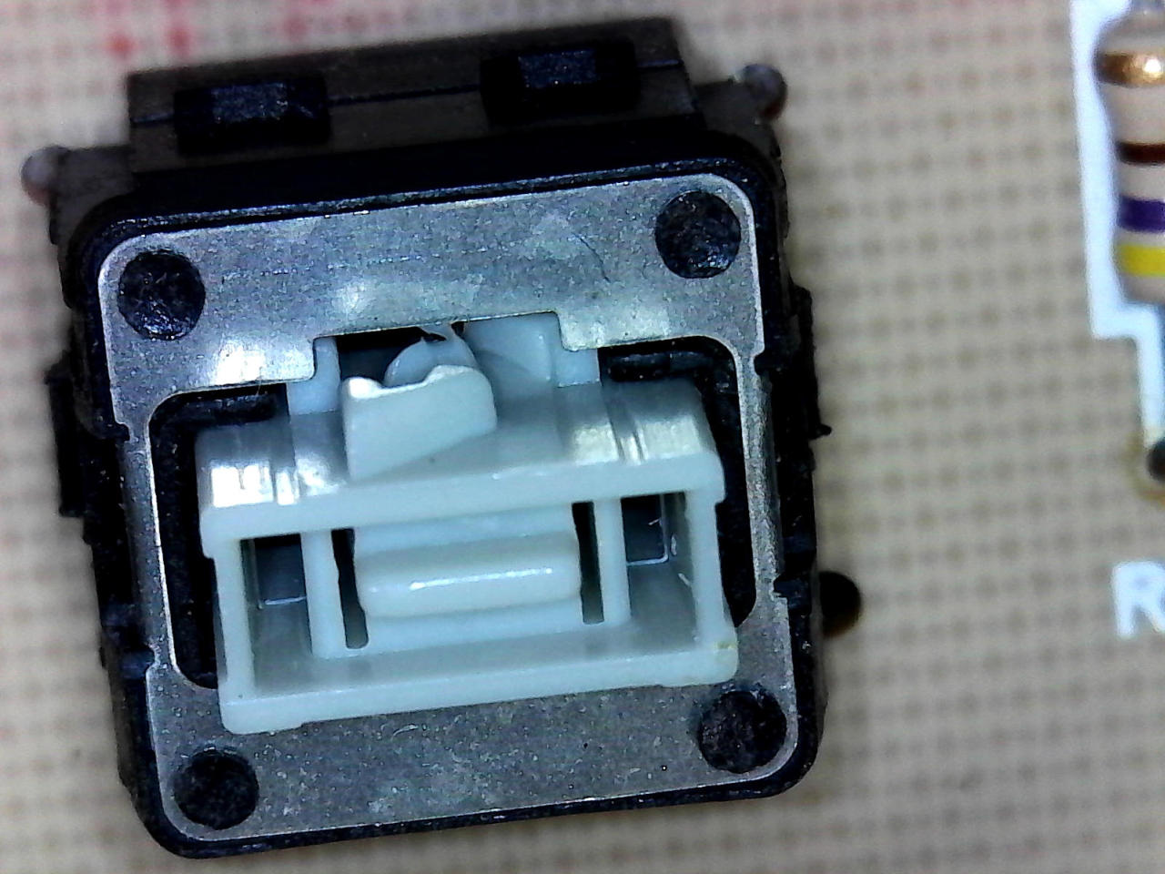

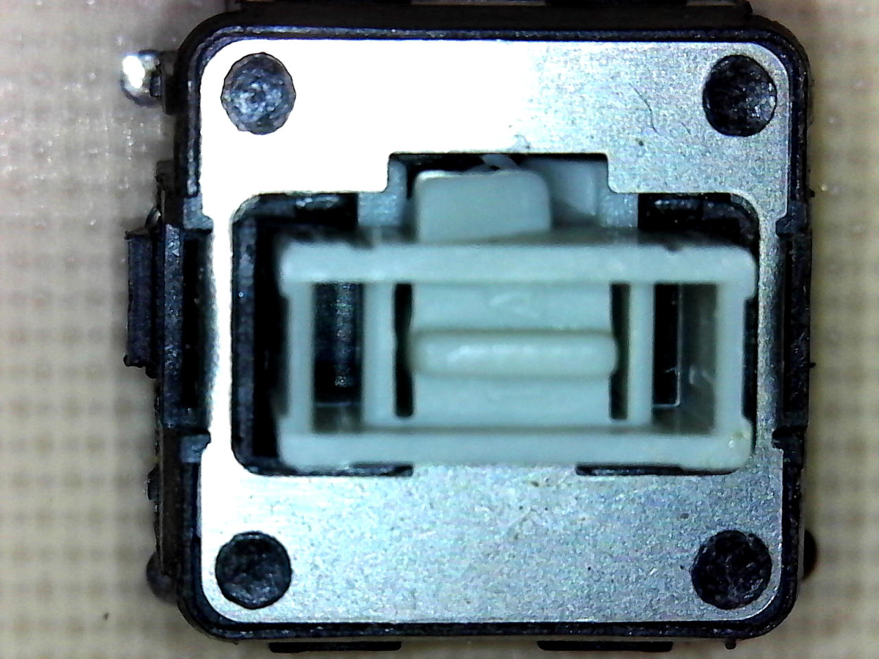

Here's some close-up shots of the switch that Ken took:

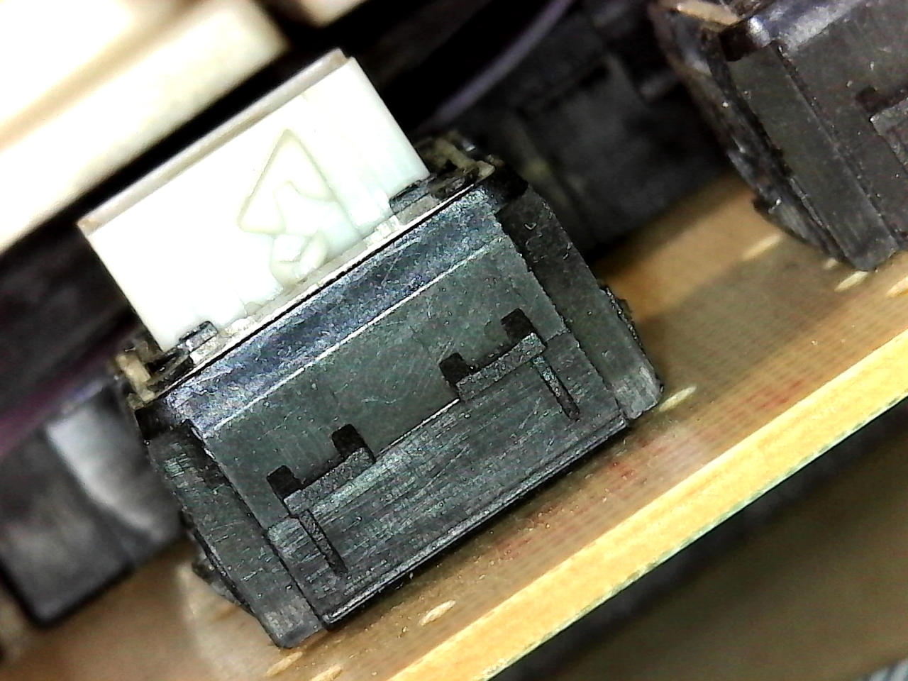

Unknown switch 1.jpg (170.92 KiB) Viewed 1730 times
Unknown switch 2.jpg (151.31 KiB) Viewed 1730 times
Unknown switch 3.jpg (114.15 KiB) Viewed 1730 times
Unknown switch 4.jpg (162.74 KiB) Viewed 1730 times
It's similar to Alps SKFL, and similar to the NEC switch that copied SKFL, but it's not the same as either. In particular, unlike SKFL, it's plate mount (though not on this keyboard). It's also a different design to SKFL Lock. Most notably, the metal lid is completely unbranded.
It looks kind of familiar, but I don't know what it is. Any ideas?

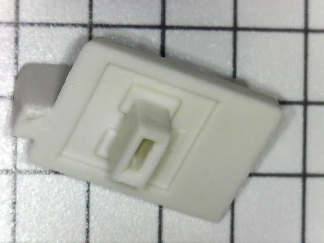

Keycap (mystery).jpg (37.93 KiB) Viewed 1729 times

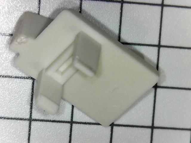

This is the keycap as used with the Alps SKFL Lock:
Keycap (regular).jpg (29.37 KiB) Viewed 1729 times
