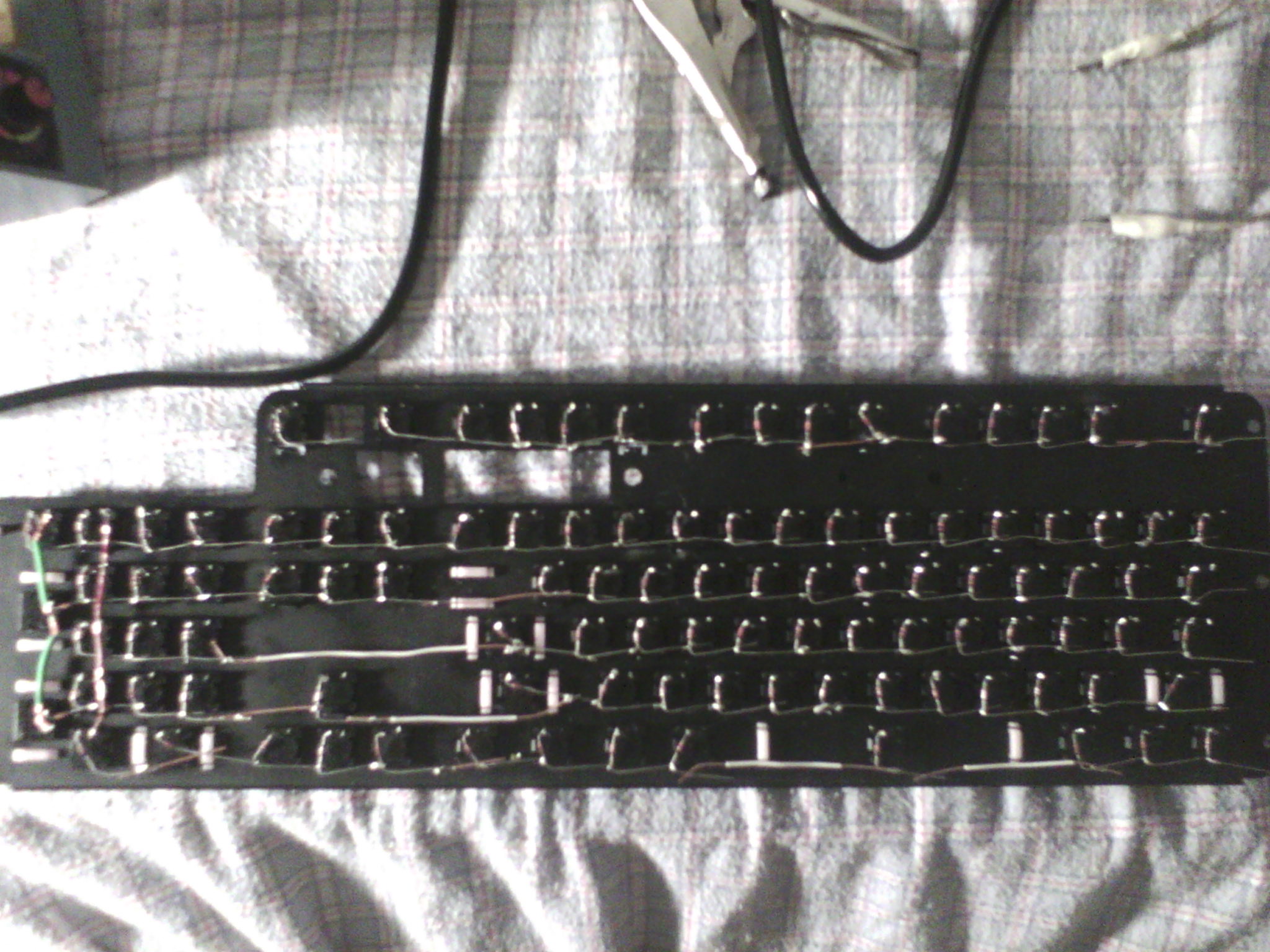

http://imgur.com/RwrflBv,yZnpZ2N Tadaaaa
For anyone who is planning on doing this project, you have to pull the switches off the metal plate before you can remove the PCB (after you desolder them). I also had to shift a pair of capacitors out of the way and wedge up a little on the metal where it caught on the processor. Then the PCB can slide out of a couple metal brackets that secure it to the metal plate.

Not too pretty but it works so far. Had to take some paint thinner to the ends of the diodes where they had tape gum on them. I was about 5 diodes short so I just pulled them off the old PCB hehe. Solid Strand telephone/thermostat wire works perfectly for the vertical rows as well.

Daniel, It does not, or at least I'm not even going to bother testing if the original chip could(the PCB was probly the main problem, I couldn't even use the up and left arrow at the same time). However now that i think about it, that chip is a dip 40, it certainly has enough inputs :/
Update: Well I'm totally stalled lol. I went and got a teensy 3.1 thinking I'm the best guy there ever was, only to realize most of the keyboard guides built their code on the teensy 2.0. Since I am pretty newb at programming, I'm either stuck learning how to do it myself with Arduino, or take the damn thing back for a teensy 2.0. Can't decide :/

I got it working! Ordered a teensy++ 2.0 and hashed out some of the Ergodox code for my layout, and some of the stuff that needed to be updated for the teensy++ 2.0 (he doesn't have any options in there for other controllers, yet) and everything but the numpad is just about sorted out. I'm thinking about making a post in the projects forum that would include the software modifications I had to do, Since that seems to be the main thing that doesn't seem to be well documented in some of the guides on here. I have to admit tho, the Ergodox code is documented very well, so much that I was able to figure most of it out by myself, and some help from the PJRC website.
