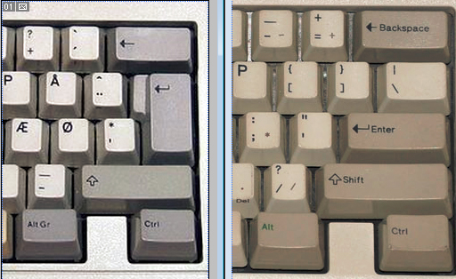

I'm thinking of buying an IBM Model M SSK. But since they were not sold in Europe, I'll have to get a keyboard with ansi layout.
But - is it possible to rearrange the keys to iso style - with the big vertical enter and æ, ø and å? And could I still use a blue cube?
Shown is my preferred key layout and the ansi style in comparison...

Yes, that should be possible. Look at this guide by ripster. He doesn't put an ISO enter on his though, and I'm not certain of how those look. Will get my first ISO model M the coming week...

You can see how they look in the ssk club thread (also some details on the bolt mod / conversion):
http://deskthority.net/photos-f62/ibm-s ... t2885.html

Bolt mod is required for access to the underside of the barrels, where you need to install an extra buckling spring for ISO. The barrel plates are universal (they can accommodate ANSI, ISO and Brazilian layouts, and an HHKB-like split backspace if you're smart) and all rows are identical so caps can be moved up and down as well. But you've got to have a buckling spring in place, and those insert from the back.

It is definitely possible. In fact, my ISO SSK was a bolt-modded ansi model. Standard bolt-mod and rearranging of hammers and inserts will give you the desired layout. The membrane is identical.
