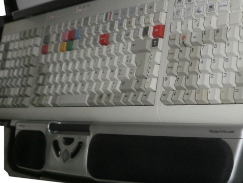

09 Jan 2015, 07:18
I wonder what you're willing to change on your keyboard just to have your mouse in a better position when there is a much simpler solution: get rid of your mouse and use a RollerMouse, i.e a pointing device placed in front of your keyboard and consisting of a bar which you can move sideways and rotate with your thumbs without changing the position of your hands.
CeeSA
09 Jan 2015, 14:31
you still have to leave your home row. Trackpoint is the better solution for me at working place ;)
For gaming with a mouse it is a real benefit to have keyboard that is narrow.
bhtooefr
09 Jan 2015, 14:59
My concern with the RollerMouse would be how it'd do for gaming, and as I understand, it's got a bit of a learning curve.
Not that TrackPoints don't have a learning curve, mind you... (And, I've actually gamed on a TrackPoint before. I'm not great at gaming, but I'm not really any worse on a TrackPoint than on a mouse.)
09 Jan 2015, 15:43
No idea about how a RollerMouse does when gaming*, I use it for work and it is just great.
No precisions issues whatsoever,
and the learning curve is for sure nothing compared to that of the keyboard layout in the OP :lol:
*no [:vomit:] smily here, I fear :mrgreen:

More information here.
Edit:
Mal-2 wrote: […] especially at a $400+ price tag. […
You can get used Tipro keyboard for just a fraction of that price. 7bit may still have some used KMXs and I some used MIDs.
