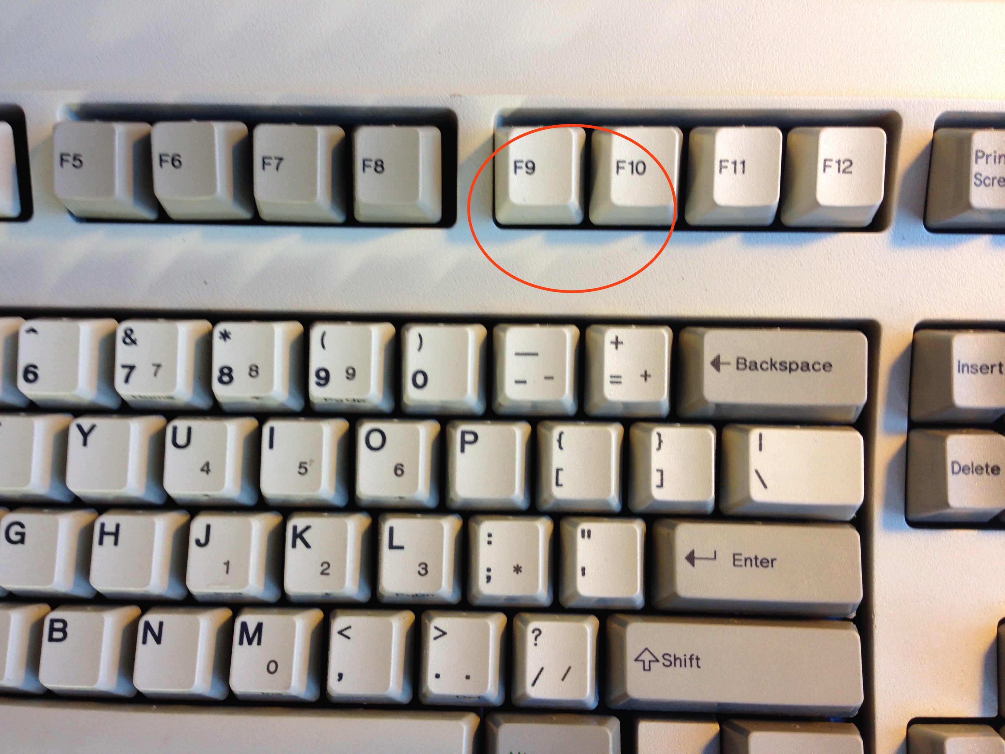

ShivaYash
08 Jan 2015, 22:10
Muirium wrote: The barrels shouldn't move at all. You're sure it's not just the springs inside? The barrels are all one big piece of plastic: the barrel frame, which must be solid for the board to work right.
They (or I should say it, as they form the frame) is able to move alright, only when pushed with my fingers I should say. When I first opened the parcel, I noticed immediately the keycaps were all pushed to the LEFT HAND SIDE, I took a photograph:
off centre keycaps.jpg (900.72 KiB) Viewed 5712 times
See the difference in gap circled in RED.
After some time of using the board this afternoon, I wanted to see why the keys were like this, so I took off a keycaps and for the first time, saw the black upright barrels. I carefully checked to see if this was aligned and I was able to re-position the barrel frame, so that the keycaps were properly centred in the top plate.
I presume this means I have many broken rivets! All the keys however are working, I checked. The only issue I am having, occasionally I should add, are the sticky SHIFTS. And the other observation, perhaps a quirk of this board, the large keys don't press if you hit the edges, one needs to almost hit the larger keys dead centre. This does not apply to the spacebar though.
The seller (a forum member) said sticky keys often are a result of the shipping process, and that I should reseat the key and press it several times. I've tried this and its not really working. Could temperature have an affect? The board was really cold when I first received it and now is up to room temperature. I should not think it would make a difference but I am new to the whole IBM game.
08 Jan 2015, 22:13
if everything is pushed to the LEFT HAND SIDE you need to stop using it and open the keyboard and take a look! The entire plate may be misaligned in the case although I have never heard of or seen such a case! This is wrong and not good. Don't use force on it. This has nothing to do with the barrels. All the barrels are fixed in place. No tempature does NOT make any difference! These keyboards are built solid! Everything you are writng sounds like there is a problem with the barrelplate alignment inside the case which I find highly unusual.
Khers
08 Jan 2015, 22:16
Given that the barrels are molded in a plate you should not be able to move them individually, which means that I guess you're moving all barrels simultaneously? It could be an indication of that all ( :shock: ) rivets are broken, or that the entire assembly is not seated properly in the case...

08 Jan 2015, 22:21
Khers wrote: Given that the barrels are molded in a plate you should not be able to move them individually, which means that I guess you're moving all barrels simultaneously? It could be an indication of that all ( :shock: ) rivets are broken, or that the entire assembly is not seated properly in the case...
Yes, sorry for my lack of terminology. I was able to very carefully shift the whole plate, all the barrels therefore moved at the same time. I'll get the correct tool tomorrow and open up the board and take a look. I think its most likely a re-seating issue, for the keyboard works, I've typed all these responses on it with no issues, other than the annoying sticky SHIFTs issue.
08 Jan 2015, 22:24
that's what ShivaYash's discription sounds like to me. Rivets could be broken too of course. :(
Don't worry about it. ;) Not important now!
Madhias
BS TORPE
08 Jan 2015, 22:30
The metal plate is fixed on two spots of the bottom frame. These two pieces could be broken, and then the plate plus keycap frame is loose. I hade this plastic things broken in one case, and fixed it with some sort of glue.
This is the spot, in the upper right corner, where the metal plate is fixed. A weak point if a Model M is sent arround the world not only once!
Image from Icarium
