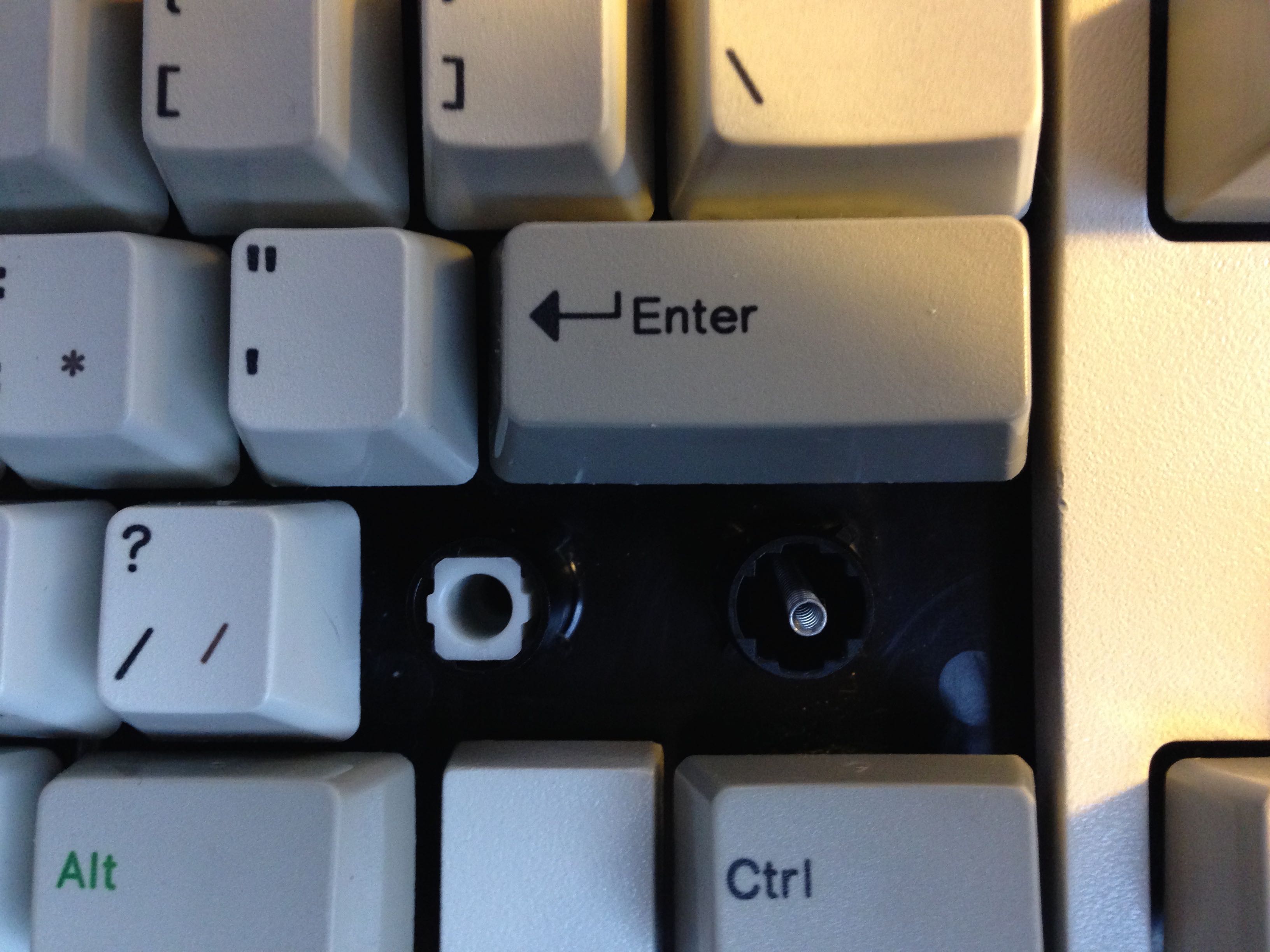

Normal? Nope. IBM would never have let that fly as standard.
Take the cap off. And shoot the stab mount insert. It could be in wrong.

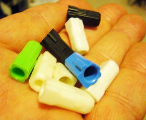

I think there are 2 types of insert right ? I remember someone mentioning that , possibly the one in the enter is wrong ?
I would lub it up and see if it helps , not too much mind you don't want it dripping down onto the membrane, something a bit thicker than oil, i used coconut oil as it was the only thing i had to hand on my 122 ansi mod but i don't recommend it. Worked well tho and smells nice .

Looks right. There's two kinds, but ANSI SSKs only use the first as the other sort is for vertical keys like ISO Return or on the numpad.
Here's how to pop it out if you want to take a look:
I'd consider pulling it out and putting back in, rotated 180°. Or maybe swapping with another of the inserts on the keyboard. Could just be a tolerance thing.

My right shift key has started playing up again. It alone sounds so different to the rest of the keys, and its driving me insane.
It just does not liked to be depressed on its right side. Pressing the right edge is fine, as is the left, and left of centre, but right of centre, it just does not go down!
Any ideas, other than to buy another KB?
20 Feb 2015, 21:56
Maybe a fresh cap? Seems like it must be some sort of tolerance issue. At worst: the barrel is the problem and may not be fixable. But different stab inserts and caps are the things to try first.
Always annoying when something's up with your dream keyboard. Model Ms aren't typically troubled by this.

I just opened her up and clearly I need a bolt mod, sooner or later.
I'd prefer not to do it in all honestly, I like running it stock. The rivets in this area, (the right hand shift) have all gone!
I am suspect movement in the barrels is causing this. During this inspection for a moment I lost the cursors! The springs moved as I tried to see between the metal plate and barrels! YIKES. I was able to recover them and all is now working. I also placed two folded up squares of paper behind the shift key area, to give some support. And I am not sure if it is this bodge, but things are now much better, UNTIL THE NEXT TIME.
