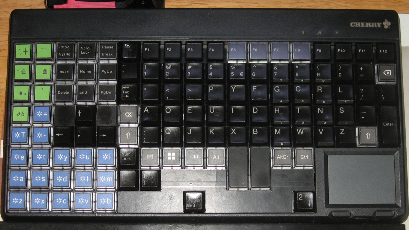

Also, I've moved to a G86-63401, the matrix model with trackpad. I like the matrix part. I wish it didn't have the trackpad (I'd much rather have 12 more keys, and it's a low-res trackpad), and I found it impossible to touch-type on the relegendable keys because they're all so broad as to feel like one solid wall of keys. It's almost as if there's no space between them. I had to steal the "normal" keys off the 61400, which means it in turn is reduced to being less than useful. (I'll probably end up buying a 62410 just to steal the keys from it, so I can turn around and sell the 61400 which is worth quite a bit more.)
So what's this new hybrid board look like? I thought you'd never ask. Oh wait, you didn't. I'm going to show you anyhow.
I tried using 2U keys as a "spacebar", but they have a tendency to get stuck down when pressed in the wrong spot. This never happens with the four 1U keys, and even if I press more than one at a time, I guess the de-bouncing algorithm perceives them as part of the same event because I don't get two spaces.
If, by chance, someone actually wants a G86-61400 that is filled with nothing but relegendable keys (except for the non-1U keys, and all but one of the bottom row modifiers), I'd be happy to post pictures. It works just fine, it just doesn't feel right under my fingers.

Update: De-bouncing must occur at the application level, because while Word and Firefox see just one press of Space when I hit two buttons, Encore and Cubase detect both. Both use the spacebar to start and stop playback, and if I catch two buttons, both programs respond by starting and instantly stopping playback (or conversely, stopping and instantly re-starting).
The 2U buttons work alright after all, if I use them upside down ("real" stem on the bottom). My thumbs never hit the spots that make them jam. I've moved the typing area as far to the right as possible, and placed the keypad on the left. The object between the keypad and alpha area is just a fragment of a membership card, and it's just floating in there to make it a bit easier to see where my hands go. I can move it to lie between the YIX and FDB columns when I catch myself crossing the mid-line with my hands and want to remind myself to stop.
The "rabbit teeth" space buttons work reasonably well, but occasionally I find myself typinglikethis because I'm tapping AltGr instead of space, and not realizing it. It happened a lot at first, but not so much any more. I still need a left thumb Space for WASD-style keying in games, that's why it hasn't been reassigned to Backspace or anything. The downside of the rabbit teeth is that they need 3U of space around each of them, one each in the outside, downward, and diagonal directions. If I were able to lower the alpha area by one row (if I had no trackpad), I wouldn't have to sacrifice 4U of space below them, only 1U to each side.
The trackpad itself I finally disabled in Device Manager. I was inadvertently clicking the buttons or tapping the trackpad, moving my cursor at inopportune moments. It also has a quite poor "DPI" or whatever the trackpad equivalent is making it not very worthwhile anyhow. It's probably adequate for the target market (point of sale systems) but it's next to useless if a real mouse is present. If offered the choice, save a few bucks AND gain twelve keys: buy the non-trackpad version.
Also, on a Skype conference call today, I was asked what kind of mechanical keyboard I have because everyone could hear me typing. The microphone base was actually in contact with the keyboard so I figured it might be direct transmission and moved the mic stand. It didn't help. So apparently, according to my cow-orkers, my keyboard is mechanical-grade loud. I was typing in Los Angeles, and they could hear me in Estonia and Sweden. :lol: It's not Buckling Spring loud, or even MX Blues loud, but it's pretty "thocky".
